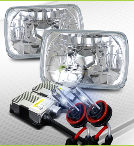

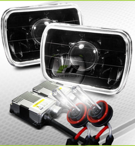

the pics below are two types of ec approved headlights for the gen2 surfs that meet the regs except 1 SELF LEVELLING.

im intrested in the normal crystal headlight kit mate im not to keen on the projector style as i think it would look a bit goofy on the lux, could be wrong but i havent seen them fitted. the mot thing is ok for this year the rules are changing for 2011 which is why i mentioned it which came from a head tech i know very well who does a lot of mot testing i mentioned hid kits to him and he told me bout the rule changes hence why i bored myself silly on rules and regs to see if he was right or not unfortuantly he was right so i was going to treat myself for crimbo then got this bombshell so go plasma gauges and clocks which i posted the other day. but to fit properly we gota think of a way to make the lux headlights self levelling then there will be no issue if it does come to light then there wont be any dissapointments or refitting old lights.

agreed bush on the regs its becoming a ball ache and a headache to fit hid to vehicles that arnt supposed to have them fitted the gutting thing is yanks get away with the self leveling but the rest of the regs stand for them aswell but i would like to see the projectors fitted to a surf to se what they look like. from the pics think it would make my surf look like it had black eyes (literaly lol) but might look diff fitted, hence why i prefer the crystal ligths. ill try find a pic of them fitted and post back here.

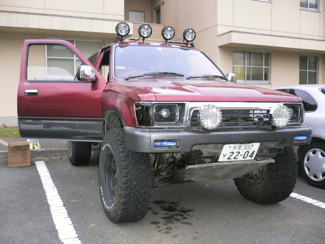

found one dont look to bad realy might change my mind afterall
